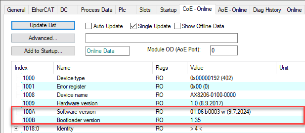

The current firmware and bootloader versions can be found in the following CoE objects:
- 100A: software version
- 100B: bootloader version
