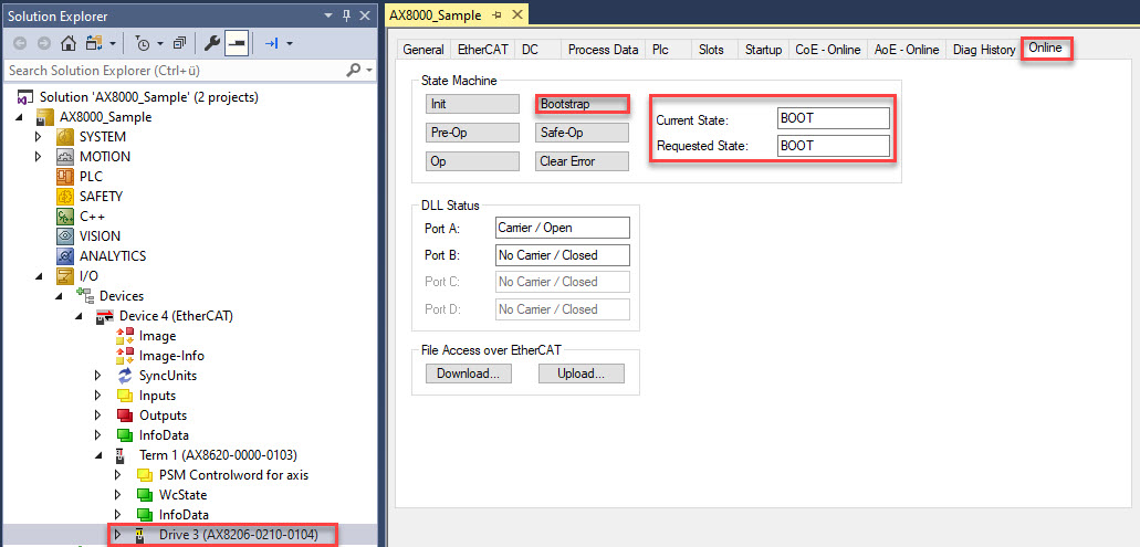

AX8000 firmware downgrade from V1.07 or higher to (V1.06–V1.03)
- ►Request device's EtherCAT state [bootstrap]
- ►Download the required firmware version via (FoE) download
- ►Confirm with OK
