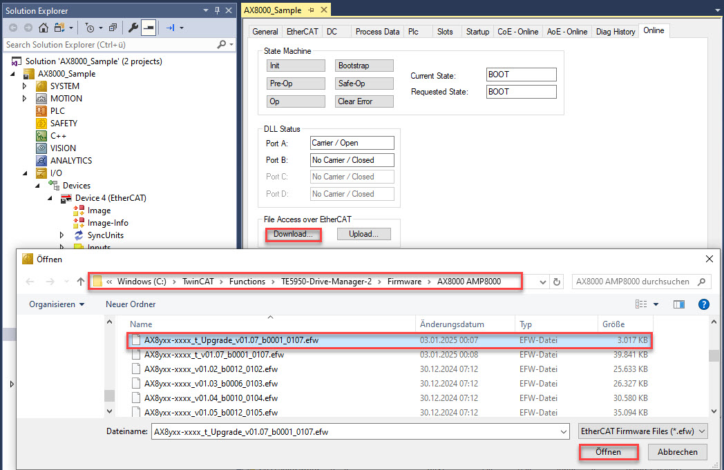

Request device's EtherCAT state [bootstrap]
Firmware update | Firmware version (V1.03–V1.06) to V1.07 or higher 4:
Download (FoE) the V1.07 upgrade file:
AX8yxx-xxxx_t_Upgrade_v01.07_b0001_0107

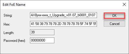

Firmware update | Firmware version (V1.03–V1.06) to V1.07 or higher 5:
Confirm with OK
Firmware update | Firmware version (V1.03–V1.06) to V1.07 or higher 6:
You do not need to enter a password.

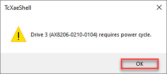

Firmware update | Firmware version (V1.03–V1.06) to V1.07 or higher 7:
Perform a Power cycle

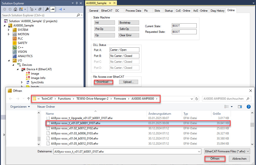

Firmware update | Firmware version (V1.03–V1.06) to V1.07 or higher 9:
Download (FoE) the V1.07 firmware file:
AX8yxx-xxxx_t_v01.07_b0001_0107

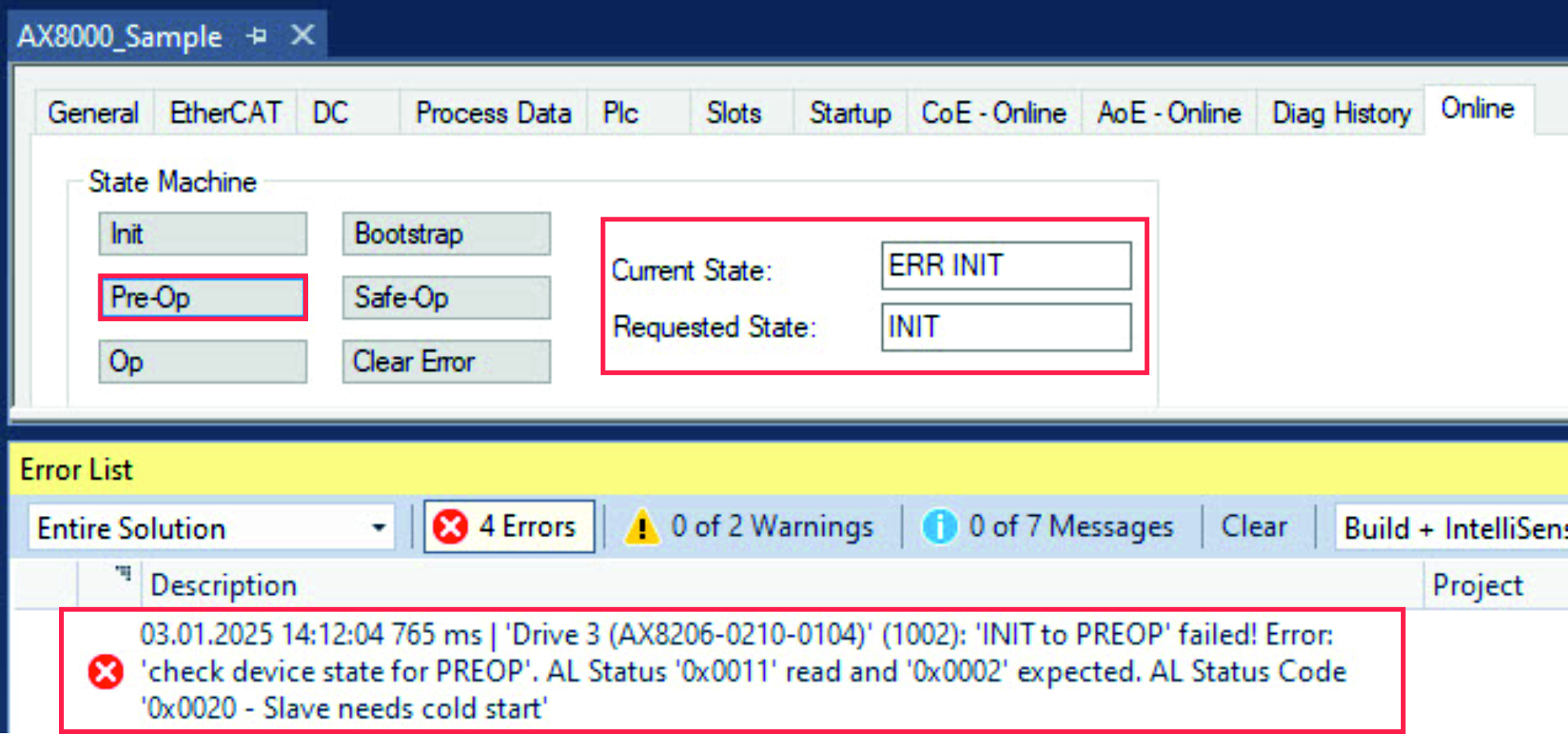

Request EtherCAT state [PreOp] of the device:
Wait for the error message:
“0x0020 – Slave needs cold start”
