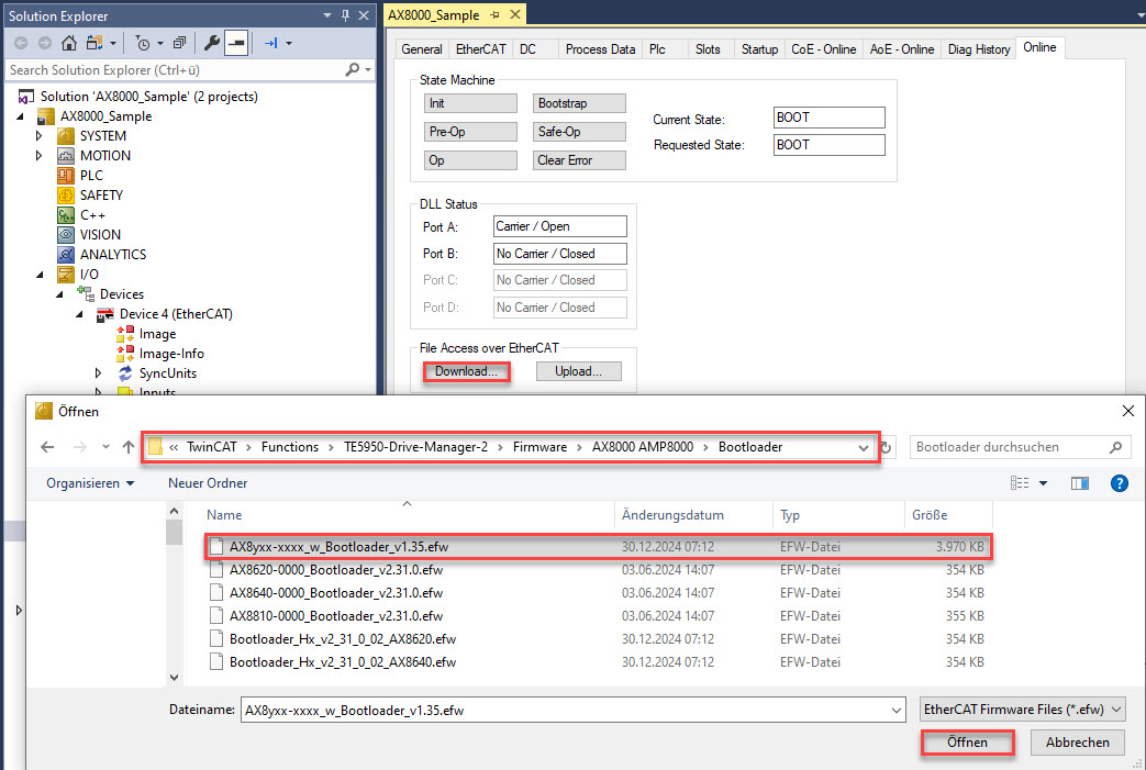

Firmware update / downgrade within firmware version V1.03–V1.06 4:
►Request device's EtherCAT state [bootstrap]
Firmware update / downgrade within firmware version V1.03–V1.06 5:
►Download (FoE) the required bootloader version

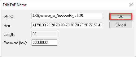

Firmware update / downgrade within firmware version V1.03–V1.06 6:
►Confirm with OK
Firmware update / downgrade within firmware version V1.03–V1.06 7:
You do not need to enter a password.
Firmware update / downgrade within firmware version V1.03–V1.06 8:
