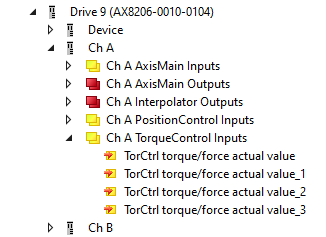

Select the created "Array Type" and issue a name [1]
Confirm with "OK" [2]
PLC integration 7:
In the Solution Explorer, left-click "Array" element
PLC integration 8:
Left-click "Linked to"
PLC integration 9:
Select "Sample" and confirm with "OK"
Repeat this step for all "Array" elements.
You can now use the "Array" in a "Scope", for example.
