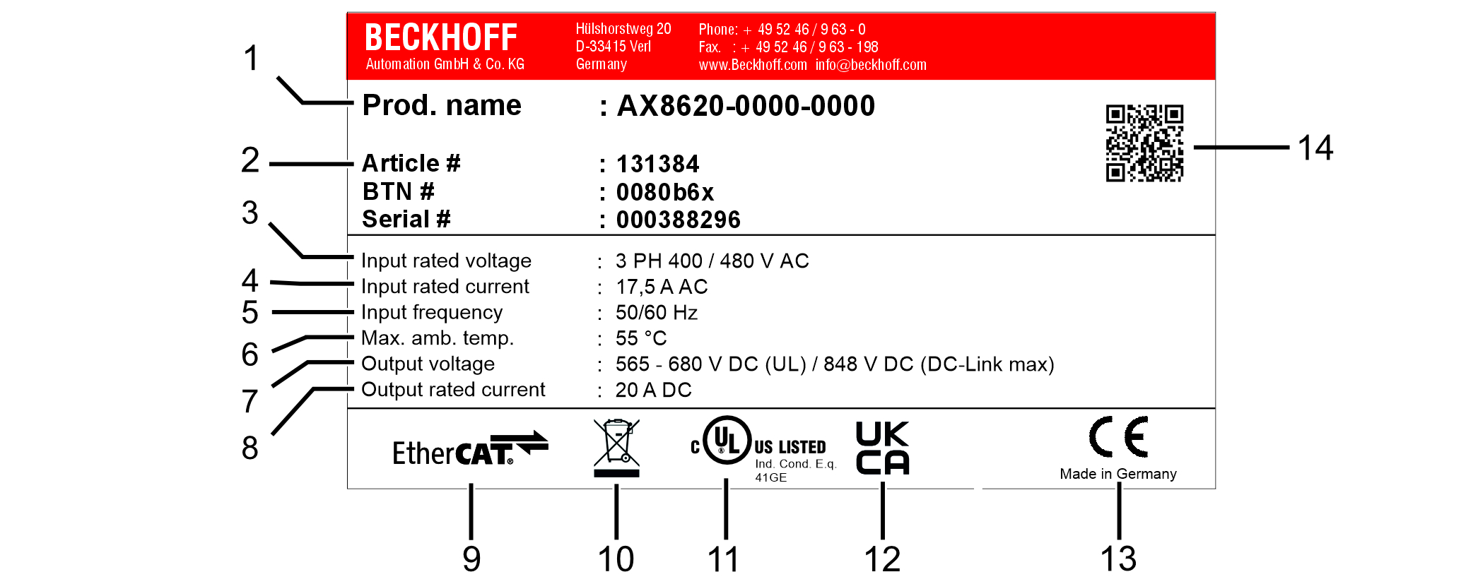

AX8620, AX8640 name plate
AX8620, AX8640 name plate 1:
Item number
Explanation
1
Order number
2
Order number
Beckhoff Traceability Number
Serial number
3
Input rated voltage
4
Input rated current
5
Input frequency
6
Maximum ambient temperature
7
Output rated voltage
8
Output rated current
9
EtherCAT conformity
10
Disposal according to WEEE directive
11
cULus approval
12
UKCA conformity
13
CE approval
14
Data Matrix Code
