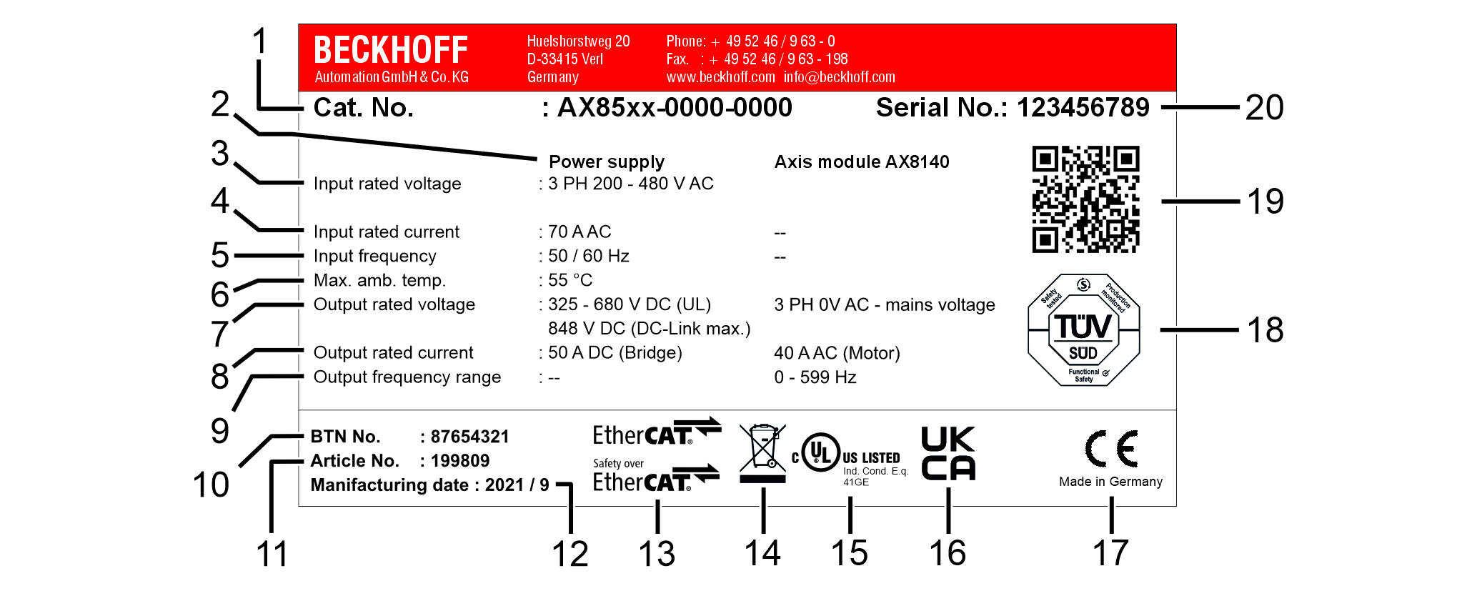

Name plate AX85xx
Name plate AX85xx 1:
Item number
Explanation
1
Order number
2
Data for power supply module and axis module
3
Nominal input voltage
4
Nominal input current
5
Input frequency
6
Maximum ambient temperature
7
Nominal output voltage
8
Nominal output current
9
Output frequency range
10
Beckhoff traceability number
11
Order number
12
Date of manufacture
13
EtherCAT conformity
Safety over EtherCAT conformity
14
Disposal according to WEEE directive
15
cULus approval
16
UKCA conformity
17
CE approval
18
TÜV certification
19
Data-Matrix Code
20
Serial number
