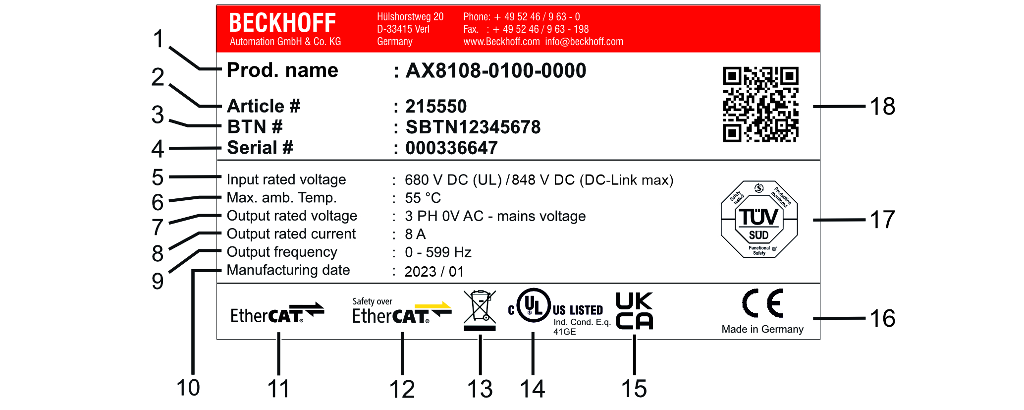

AX81x8, AX8206 name plate
AX81x8, AX8206 name plate 1:
Item number
Explanation
1
Order number
2
Order number
3
Beckhoff traceability number
4
Serial number
5
Input rated voltage
6
Maximum ambient temperature
7
Output rated voltage
8
Output rated current
9
Output frequency range
10
Date of manufacture
11
EtherCAT conformity
12
Safety over EtherCAT conformity
  • Order designations AX8xxx-x1xx and AX8xxx-x2xx only
13
Disposal according to WEEE directive
14
cULus approval
15
UKCA conformity
16
CE conformity
17
TÜV certification
18
Data-Matrix Code
