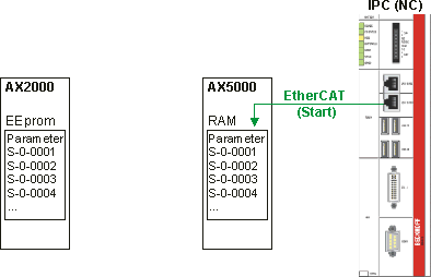

Parameter handling 1:
The parameters are transferred from the controller to the servo drive when the EtherCAT system starts up. Due to the high transmission rate offered by EtherCAT this process is very fast, even in larger systems.
