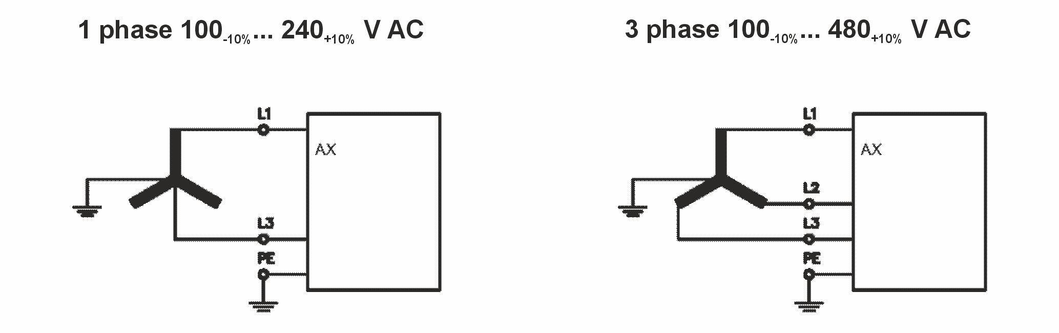

Supply network connection (X01)
The servo drives of the AX5000 series are equipped with a wide-range voltage input "X01" and can be connected to voltage systems between one-phase 100 V AC -10% and
three-phase 480 V AC +10%.
Supply network connection (X01) 1:
Note
Connection to the standard supply network (TT/TN) with grounded center is described below. For information on connections to other supply networks (e.g., IT network, isolating transformers, etc.), please refer to the “AX5000 User Manual” on the enclosed CD or download it from the website at www.beckhoff.com.
Supply network connection (X01) 2:
Supply network connection (X01) 3:
The AX5000 may only be connected to a standard supply network with a grounded
center, whereby the max. voltage to ground
may not exceed 277 V (+10%).
