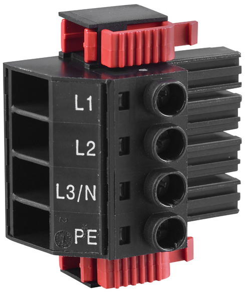

X01 – wide-range voltage input
AX51xx and AX52xx
Terminal point | Connection | Tightening torque | |
3-phase | 1-phase | ||
L1 | Phase L1 | Phase L1 | 0.5…0.6 Nm |
L2 | Phase L2 | not used | |
L3/ N | Phase L3 | Neutral conductor | |
PE | Protective conductor | Protective conductor | |
