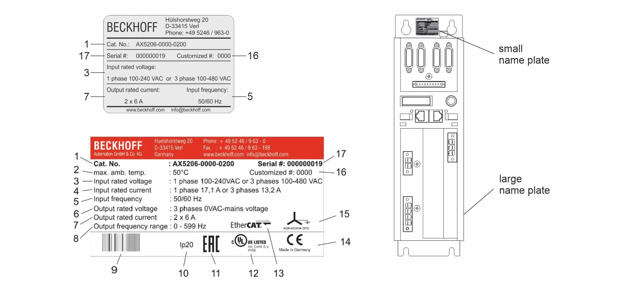

Name plates
The servo drive features two name plates. A comprehensive name plate can be found on the right-hand side. An extract showing the main data can be found at the top of the servo drive.
1 | Order number | 7 | Rated output current | 13 | EtherCAT compliant |
2 | Max. ambient temperature | 8 | Output frequency range | 14 | CE-compliant |
3 | Rated input voltage | 9 | Barcode | 15 | Standard supply network with grounded center |
4 | Rated input current | 10 | Protection class | 16 | Customer-specific |
5 | Input frequency | 11 | EAC approval | 17 | Serial number |
6 | Rated output voltage | 12 | cULus approval |
