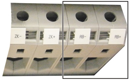

AX5160 and AX5172
Terminal point | Connection |
RB + | Ext. braking resistor + |
RB - | Ext. braking resistor - |

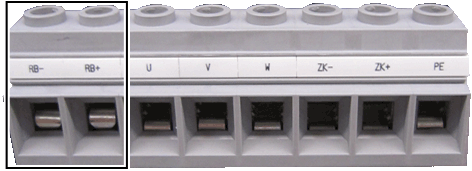

AX5190 and AX5191

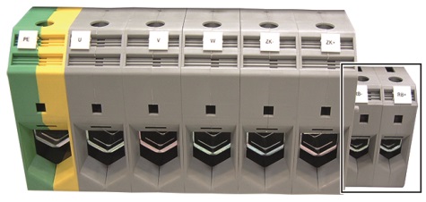

AX5192 and AX5193
