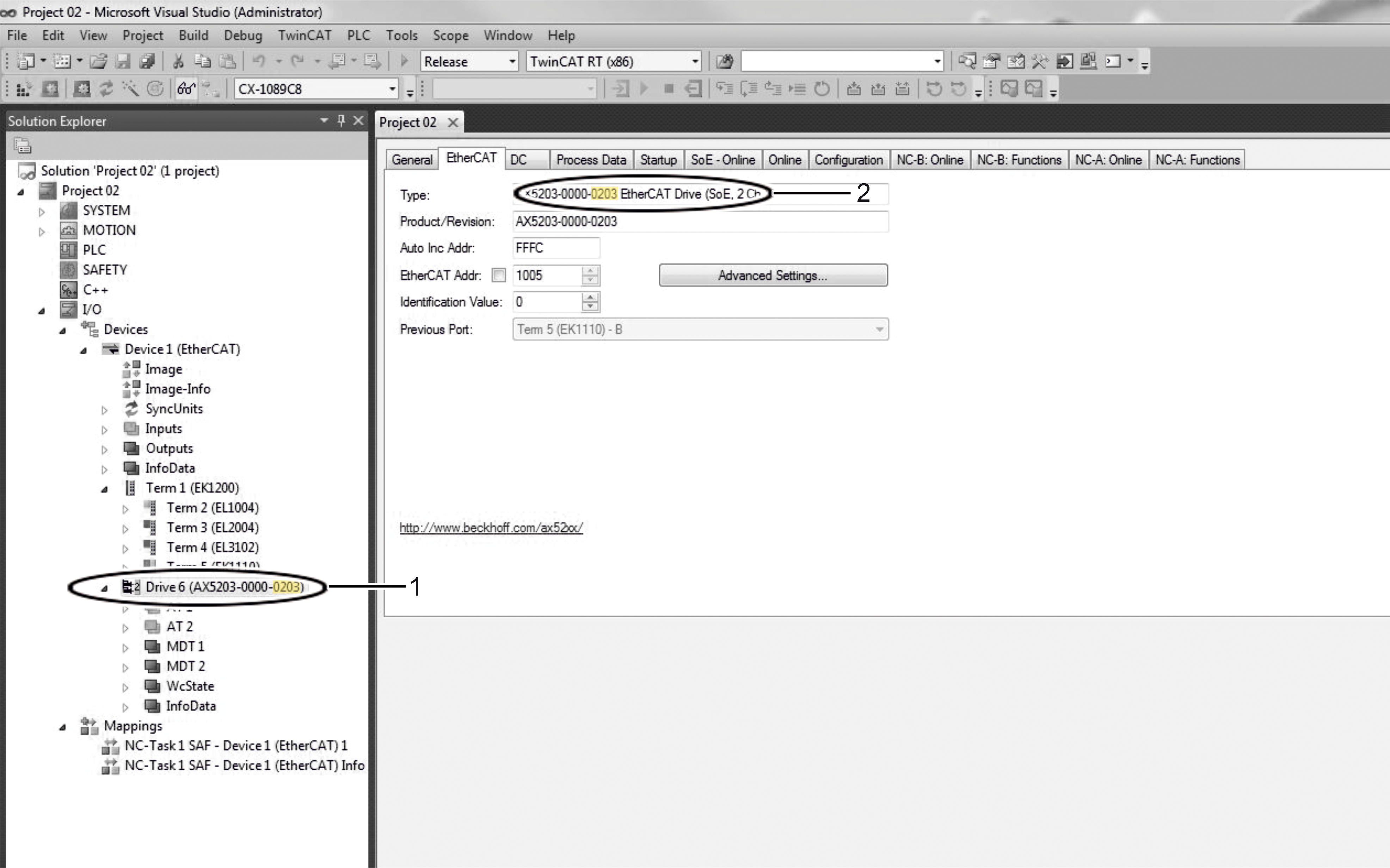

The functionality of some parameters depends on the interface revision of the servo drive. Beckhoff support may query the interface revision.
Interface revisions 1:
If the AX5000 is added, the interface revision is indicated in the structure (1) in the device name. This device name can be changed by the user. Therefore, please always read the interface revision at the location indicated above (2).
Interface revisions 2:
For further information please look into the involved IDN:
S-0-0030
Interface revisions were published for the two hardware versions of the AX5000. The Firmware column shows the highest released build number for an interface.
