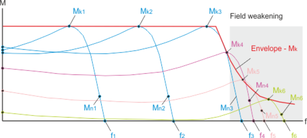

Typical torque / speed curve of an asynchronous motor
The diagram describes the characteristic curve at a rotary field frequency.

Operation in the field weakening
In the field weakening, the envelope follows the function M=1/n. In the linear range (Mk4 / Mk5), a decrease of the rotary field frequency causes a significant increase of the torque.
During operation of an asynchronous motor the torque curves may differ, depending on the rotary field frequency (f).
Behavior of the stalling torques with changed field weakening:
- Until the field weakening is reached, the stalling torques (Mk1 - Mk3) are equal.
- At the beginning of the field weakening, the stalling torques (Mk4 and Mk5) decrease almost linearly.
- With increasing field weakening (Mk6 and further), the stalling torque is very low and almost constant.
