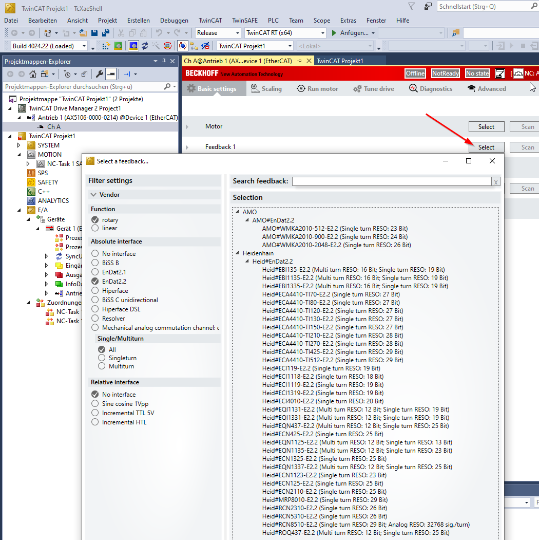

The motor feedback must be supported by the AX5000. You can obtain information on this in the AX5000 system manual and see a list of the feedbacks in the Drive Manager:
