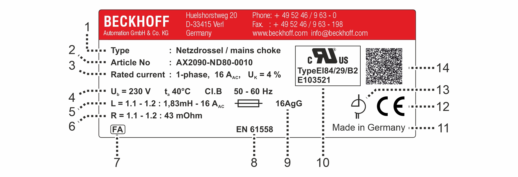

Name plate
Number | Explanation |
1 | Article name/product type |
2 | Order number/order identifier |
3 | Rated current; AAC with indication of the short-circuit voltage; UK |
4 | Supply voltage; Ub with indication of ambient temperature; ta, coil insulation material class; B and mains frequency; 50 ... 60 Hz |
5 | Inductance |
6 | Resistance |
7 | Serial number |
8 | European standard EN 61558 |
9 | Back-up fuse |
10 | UR certification with specification of the E-number |
11 | Country of manufacture |
12 | CE certification |
13 | Mains choke |
14 | Data Matrix Code with Beckhoff BTN |
