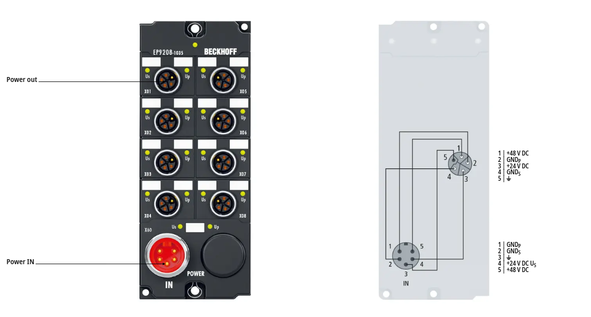

The EP9208-1035 EtherCAT Box is a fully passive distribution box. It is supplied via a 7/8" connector. The eight outputs are executed as M12 sockets with L-coding according to EN 61076; the EP9208-1035 is thus suitable for carrying currents up to 16 A at 24 V DC/48 V DC on two channels per socket. The sockets and the supply each have an LED to display the channels. The input and outputs of the EP9208-1035 are connected directly with no intermediate electronics. The EP9208-1035 makes it very easy to power integrated drives, such as the AMI8100 and ASI8100.
