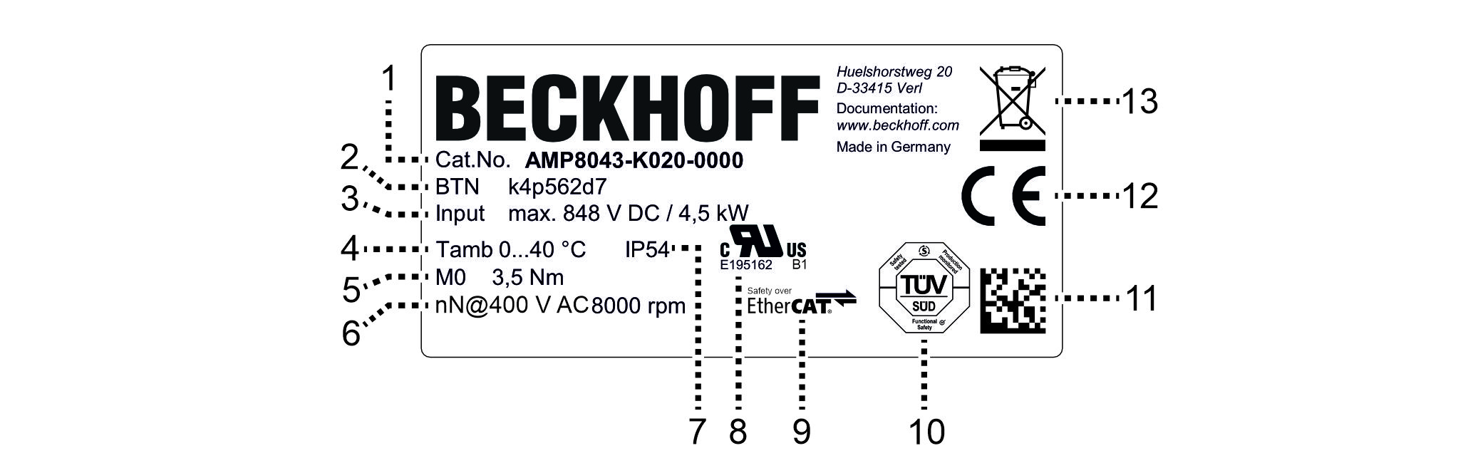

Name plate AMP80xx, AMP85xx
Item number | Explanation |
1 | Servo drive type |
2 | Beckhoff Traceability Number, BTN |
3 | Maximum input voltage and power |
4 | Ambient temperature |
5 | Standstill torque |
6 | Rated speed at 400 V AC supply voltage |
7 | Protection rating |
8 | cURus approval |
9 | EtherCAT conformity |
10 | TÜV test mark |
11 | Data Matrix code with Beckhoff TN |
12 | CE conformity |
13 | Disposal according to WEEE Directive |
14 | Hazard warnings |
