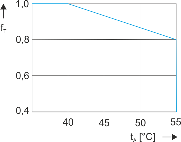

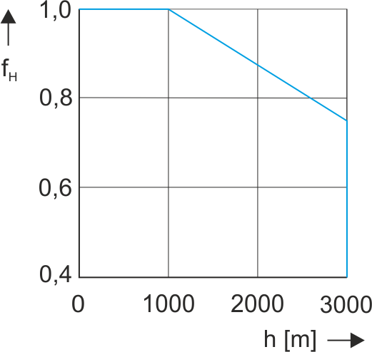

Power derating
Ambient temperature
Installation altitude
Power derating 1:
fT = Temperature utilization factor
tA = Ambient temperature °C
Power derating 2:
fH = Altitude utilization factor
h = Altitude in meters
Calculation of the power data when exceeding the specified temperature limit > 40 °C:
FCA_red = FCA x fT
Calculation of the power data when exceeding the specified installation altitude ≥ 1000 m:
FCA_red = FCA x fH
Calculation of the power data when exceeding the specified limits:
Ambient temperature > 40 °C and installation altitude ≥ 1000 m
FCA_red = FCA x fT x fH
