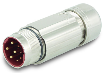

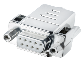

M23 connector for power supply and D-Sub connector for temperatur contact

Power connector
Contact
Signal
Connector M23
(8-poles)
1
U
M23 connector for power supply and D-Sub connector for temperatur contact 3:
2
PE
3
W
4
V
Case
Shield
Temperature contact
Contact
Signal
D-Sub Connector
(9-poles)
5
KTY
M23 connector for power supply and D-Sub connector for temperatur contact 4:
9
KTY
2
PTC
6
PTC
Case
Shield
