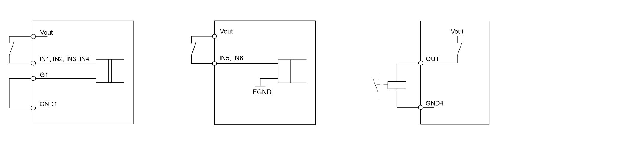

Wiring X03 (2-channel)
Notice

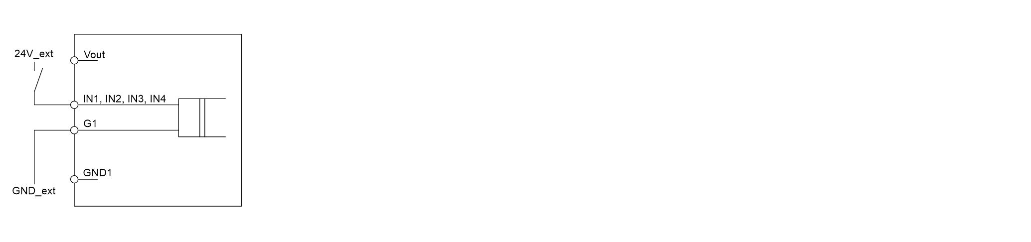

Damage due to improper connection of external 24 V
Connecting an external 24 V power supply to the internal 24 V power supply Vout can lead to excess voltage and instability of the internal voltage control. This can damage electronic components and circuit breakers, trigger short circuits or thermal overheating and cause fire or electric shock hazards.
  • Never connect the internal power supply to an external power supply
  • Only use supply points approved by the manufacturer
Using the internal
Wiring X03 (2-channel) 1:
Using an external
24 V power supply
Wiring X03 (2-channel) 2:
