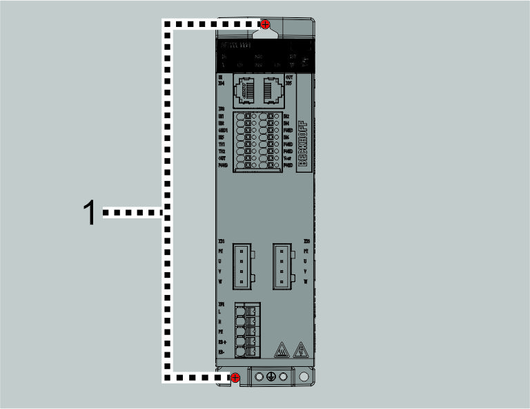

Mounting in the control cabinet 2:
The economy variable frequency drive AF1000 has two
mounting points [1], which are used to secure it to the mounting plate with mounting screws.

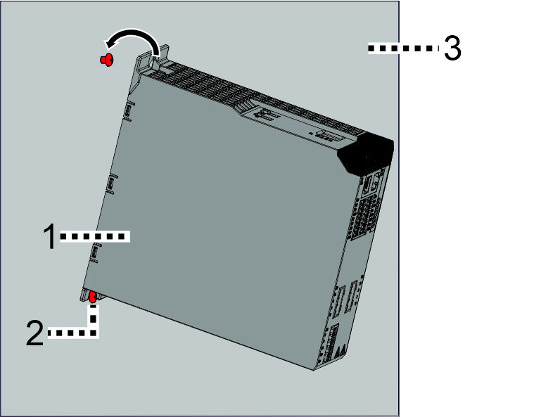

Mounting in the control cabinet 3:
►Screw the screws into the control cabinet mounting plate
►Place product [1] on the lower screw [2] and carefully press it against the mounting plate [3]
Mounting in the control cabinet 4:
►Guide the upper screw [1] through the large recess on the upper flange of the housing [2]
►Tighten all the screws in the elongated holes in the module housing
►Observe tightening torques
