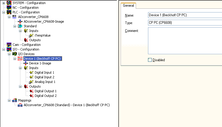

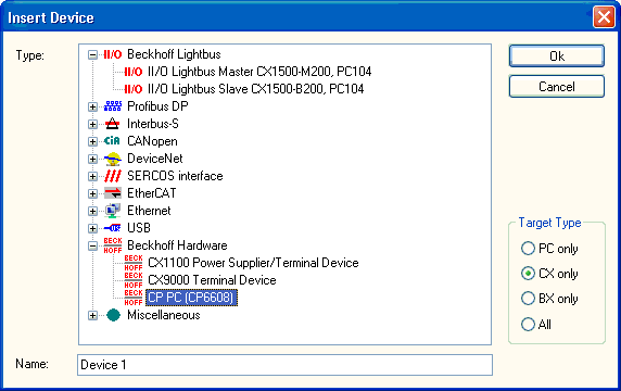

Insert the device named 'CP PC (CP6608)' under I/O Devices.
Further on, the variable 'Analog Input 1' is to be mapped to the PLC input variable.

uiRawValue : Analog Input 1 read from System Manager device CP PC(CP6608) is assigned to this variable.
