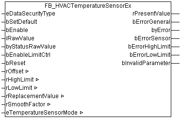

FB_HVACTemperatureSensorEx
FB_HVACTemperatureSensorEx 1:

eDataSecurityType  : E_HVACDataSecurityType;
bSetDefault        : BOOL;
bEnable            : BOOL;
iRawValue          : INT;
byStatusRawValue   : BYTE;
bEnableLimitCtrl   : BOOL;
bReset             : BOOL;

rPresentValue         : REAL;
bErrorGeneral         : BOOL;
byError               : BYTE;
bErrorSensor          : BOOL;
bErrorHighLimit       : BOOL;
bErrorLowLimit        : BOOL;
bInvalidParameter     : BOOL;

rOffset               : REAL;
rHighLimit            : REAL;
rLowLimit             : REAL;
rReplacementValue     : REAL;
rSmoothFactor         : REAL;
eTemperatureSensorMode: E_HVACTemperatureSensorMode;
