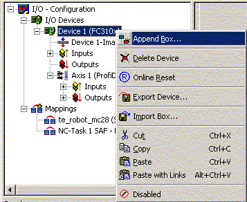

Configuration of ProfiDrives
1. Append a Box to the Profibus Master

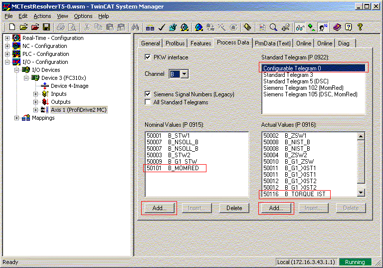

5. Configurable Telegram
5.1 Extend Telegrams
Add the additional parameters (like moment reduction and actual torque) to the drive with SimoComU first (see SimoComU ProfiDrive Configuration). Then check for the Siemens parameter number online in the System Manager (i.e. 50116 = actual torque).
Change the telegram type from 3 to 0. Then the "Add..." buttons for the Nominal and the Actual Values are automatically enabled.
Press "Add..." of the Nominal Values and add parameter MOMRED (101). This parameter is in the list.
The channel identifier "A_" or "B_" and the 50000 to the parameter number are added automatically after pressing OK.
Press "Add..." of the Actual Values and add parameter TORQUE_IST (116). The proper data type must be selected. Look for parameter number and data type in SimoComU.
5.2 Extended Telegram 3
5.3 Extended Telegram 5
5.4 New cyclic Interface
Now the cyclic interface of the ProfiDrive contains the new data (i.e., for torque limiting and actual torque). These values can now be linked to the PLC.
