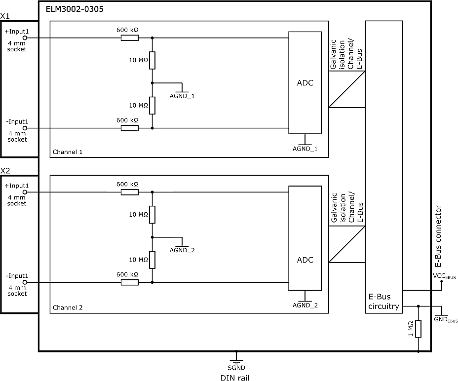

Abb.248: ELM3002-0305

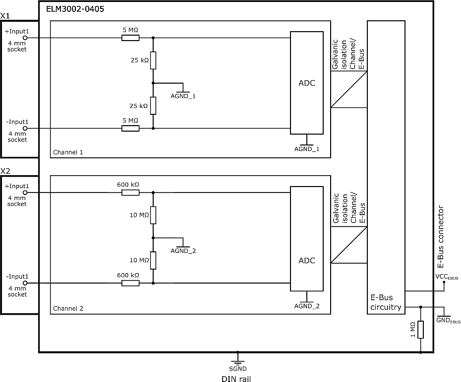

Abb.249: ELM3002-0405

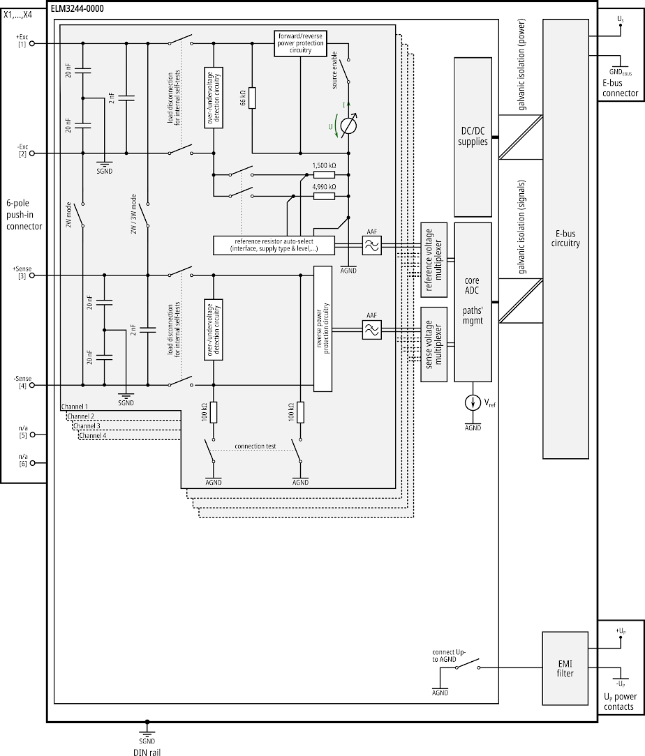

Abb.255: Potential-Schemata ELM3244-0000

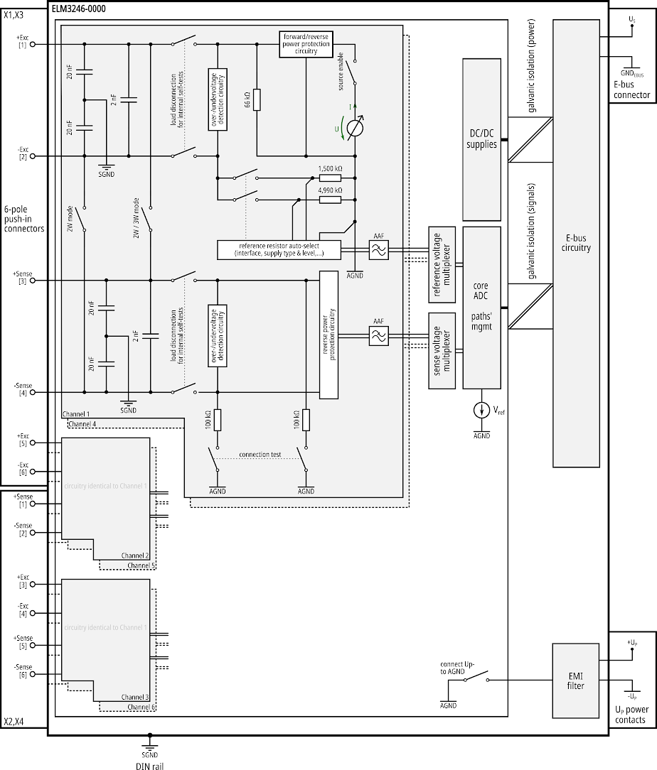

Abb.256: Potential-Schemata ELM3246-0000
