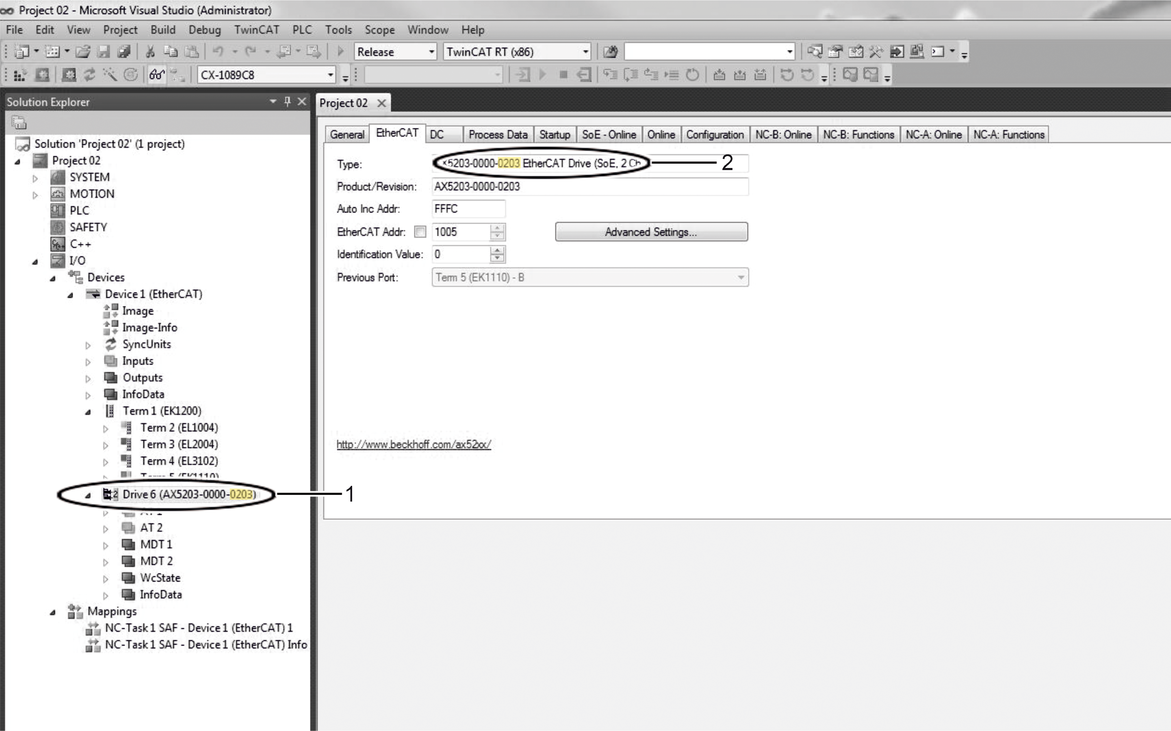

The functionality of some parameters depends on the interface revision of the servo drive. Beckhoff support may query the interface revision.
If the AX5000 is added, the interface revision is indicated in the structure (1) in the device name. This device name can be changed by the user. Therefore, please always read the interface revision at the location indicated above (2).
