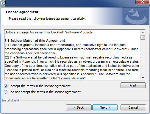

Accept the end user licensing agreement and click Next.

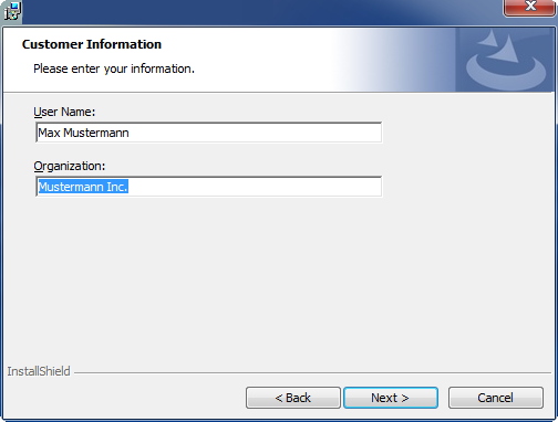

Enter your user data.

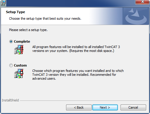

If you want to install the full version of the TwinCAT 3 function, select Complete as the installation type. If you want to install the TwinCAT 3 function components separately, select Custom.

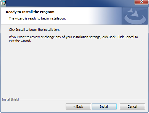

Click Next, then Install to start the installation.

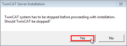

A dialog box informs you that the TwinCAT system must be stopped to proceed with the installation.
Confirm the dialog with Yes.

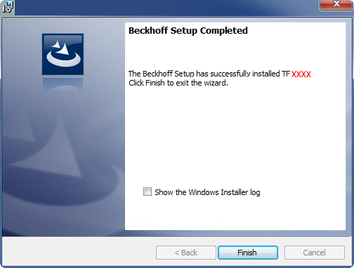

Click Finish to exit the setup.
Installation 6:
The TwinCAT 3 function has been installed successfully.
