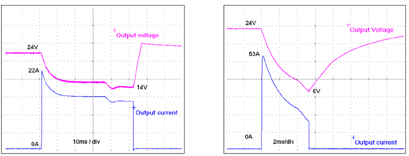

The extra current (peak current) is supplied by the power converter and the built-in large sized output capacitors of the power supply. The capacitors get discharged during such an event, which causes a voltage dip on the output. The following two examples show typical voltage dips:
Peak current voltage dips | |
Typ. from 24V to 16V | at 20A for 50ms, resistive load |
Typ. from 24V to 12V | at 50A for 2ms, resistive load |
Typ. from 24V to 6V | at 50A for 5ms, resistive load |
