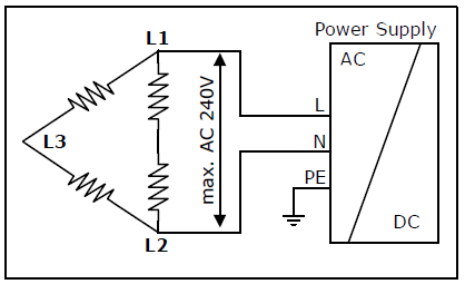

Operation on two phases
The power supply can also be used on two phases of a three-phase system. Such a phase-to-phase connection is permissible as long as the supply voltage is below 240 V+10 %.
Fig.21: Operation on two phases Make sure that the conductor connected to the N terminal is fused appropriately.
