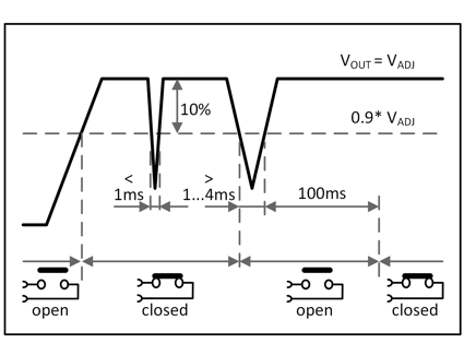

DC-OK relay contact
This feature monitors the output voltage at the output terminals of an active power supply.
The contact closes
when the output voltage typically reaches 90% of the set output voltage.
The contact opens
when the output voltage drops more than 10% below the set output voltage. Short drops are extended to a signal length of 100ms. Drops that are shorter than 1ms are ignored.
Switching hysteresis
1 V
Contact load capacity
Maximum 60Vdc 0.3A, 30Vdc 1A, 30Vac 0.5A, ohmic load
Minimum permissible load: 1mA at 5Vdc
Insulation voltage
See the dielectric strength table in the chapter on Safety features
DC-OK relay contact 1:
Behavior of the DC-OK relay contact
