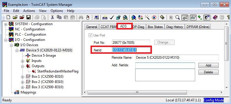

ADS-Interface
ADS NetId of the PROFIBUS interface
A NetId is required for the ADS communication. This can be found in the ADS tab of the PROFIBUS interface in the TwinCAT System Manager.
ADS-Interface 1:
