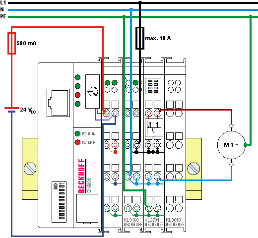

The example illustrates control of an AC motor through a KL2791. The mains voltage (230 VAC) is supplied to the power contacts via the KL9160 power feed terminal.
KL2791 - application example 1:Fig.14: KL2791 - application example
WARNING
Protective earth (PE)
If your motor needs to be earthed, connect its earthing contact directly to PE (protective earth) of your switch cabinet or sub-distribution board and not to the KL2791 dimmer terminal!
A power feed terminal can supply several speed controller terminals.
