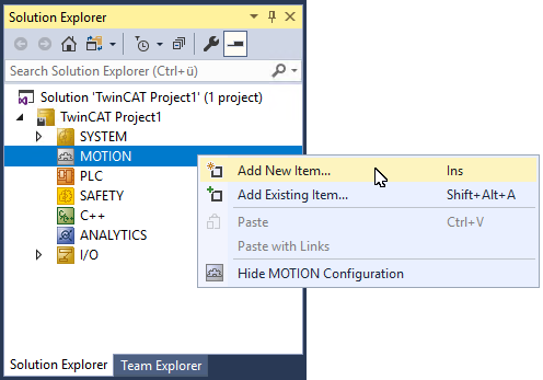

- 1. Right click on "MOTION" and select "Add New Item..." .
- A new NC task is created.

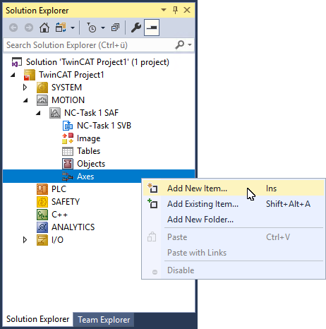

- 2. Right click on "Axes" and select "Add New Item".

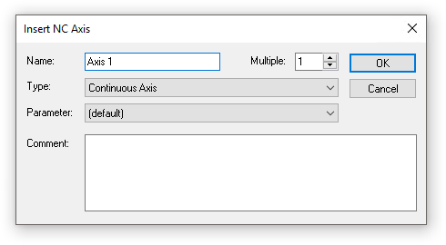

- A dialog box appears:
- 3. In the field "Type" select the entry "Continuous axis" and confirm with "OK".

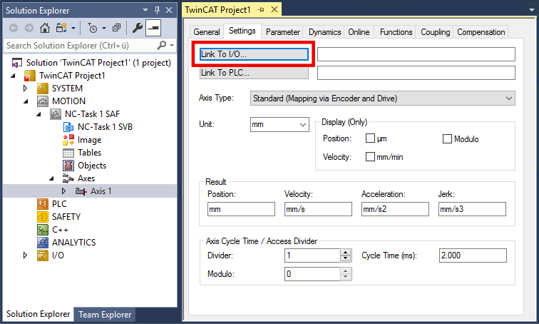

- 4. Double-click the new axis.
- 5. Click on the "Settings" tab.
- 6. Click on the button "Link To I/O..." .

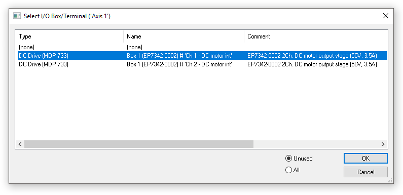

- A dialog box appears. It shows the available motor channels.
- 7. Select the appropriate entry and confirm with "OK".
The assignment of the connector pins to the motor channels can be found in chapter Signal connection.
- The process data are linked to the NC task.
