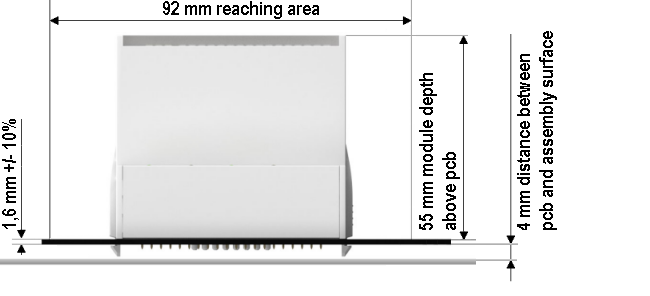

Note the dimensions shown in the following diagram for the design of the signal distribution board to ensure safe latching and simple assembly / disassembly of the modules.
Minimum distances for ensuring installability 1:
Mounting distances EJ module - PCB
Minimum distances for ensuring installability 2:
Observing the reaching area
A minimum reaching area of 92 mm is required for assembly / disassembly, in order to be able to reach the mounting tabs with the fingers.
Adherence to the recommended minimum distances for ventilation (see section Installation position) ensures an adequate reaching area.
The signal distribution board must have a thickness of 1.6 mm and a minimum distance of 4 mm from the mounting surface, in order to ensure latching of the modules on the board.
