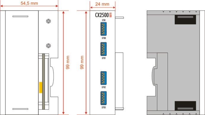

The system interface CX2500-0070 expands a CX20x0 by four further USB interfaces.
Technical data
CX2500-0070
Interfaces
4 x USB 3.0, Type A
Power supply
via system bus (via power supply module CX2100-0xxx)
Current supply
max. 900 mA each Port max. 2000 mA total current
max. Power loss
2.4 W
Dielectric strength
500 V (supply / internal electronics)
Dimensions (W x H x D)
24 mm x 99 mm x 54,5 mm
Weight
approx. 195 g
Operating/storage temperature
-25° C ... +60° C / -40° C ... +85° C
Relative humidity
95% no condensation
Vibration/shock resistant
conforms to EN 60068-2-6 / EN 60068-2-27
EMC immunity/emission
conforms to EN 61000-6-2/EN 61000-6-4
Protection class
IP 20
