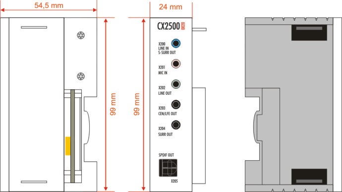

Technical data
The system interface CX2500-0020 expands a CX20x0 by audio interfaces.
Technical data |
CX2500-0020 |
Interfaces |
Line IN, Line OUT, Mic IN, 7.1, SPDIF |
Power supply |
via system bus (through CX2100-0xxx power supply modules) |
max. Power loss |
0.024 W |
Dielectric strength |
500 V (supply / internal electronics) |
Dimensions ( W x H x D) |
24 mm x 99 mm x 54,5 mm |
Weight |
approx. 180g |
Operating/storage temperature |
-25° C ... +60° C / -40° C ... +85° C |
Relative humidity |
95% no condensation |
Vibration/shock resistant |
conforms to EN 60068-2-6/EN 60068-2-27 |
EMC immunity/emission |
conforms to EN 61000-6-2/EN 61000-6-4 |
Protect. class |
IP 20 |
