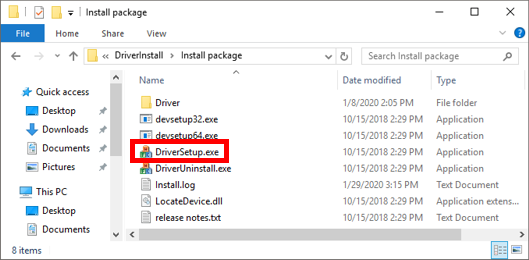

1. Make sure that the USB stick is not yet connected to the Industrial PC.
2. Run the DriverSetup.exe file to start the installation.
Installing the driver 1:
3. Following successful installation, an entry is made in the log file Install.log. The installation routine does not give any feedback about the success of the installation.
The following message may appear after the installation: "This program might not have installed correctly". You can ignore this message.

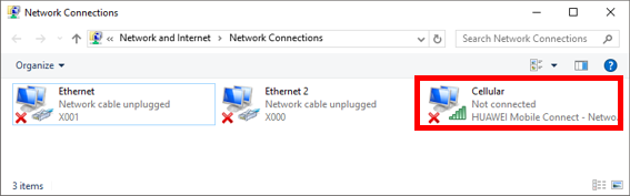

4. Connect the USB stick. The USB stick is ready for operation in the background following a short installation.
  • The driver has been successfully installed if a new interface for mobile connections appears.
    Installing the driver 2:
    In the next step you can start a mobile communication connection.
