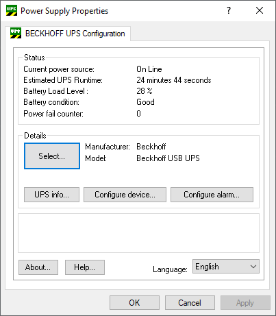

UPS configuration dialogs
Start the configuration dialog under Start > Programs > UPS configuration.
This dialog can be used for example to perform device-specific settings or a firmware update. In addition, the time can be set for how long the UPS should support the devices connected to it and the delay time for switching off the UPS. Only a user with administrator rights can set the settings of the UPS.
UPS configuration dialogs 1:
Status: Shows major information about the current power source and battery load information.
Power fail counter: From UPS software version >= 3.0.0.6. The counter is reset at UPS service start and counts the detected power fails.
Details: Shows current configured UPS model and manufacturer name. Manufacturer name "(None)" means UPS service not configured and deactivated.
